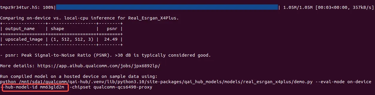

Run compiled model on a hosted device on sample data using:
python /mnt/sda1/qualcomm/qai-hub/.venv/lib/python3.10/site-packages/qai_hub_models/models/real_esrgan_x4plus/demo.py --eval-mode on-device --hub-model-id mm63gld2m --chipset qualcomm-qcs6490-proxy

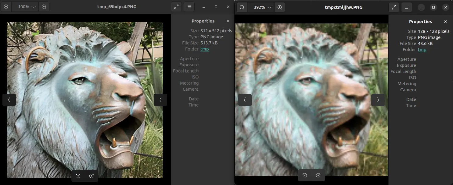

QAI HUB MODELS 模型推理 Demo​
根据用户模型编译示例中最后的打引提示,可以在云端设备上推理编译后模型并查看推理结果
请修改 hub-model-id 参数为模型编译结果最后打印的 hub-model-id
hub-model-id 具体参数位置
python3 -m qai_hub_models.models.real_esrgan_x4plus.demo --eval-mode on-device --hub-model-id mm63gld2m --chipset ${PRODUCT_CHIP}
(.venv) (gen_py3.10) radxa@vms-max:~/Job/git_clone/ai-hub-models$ python3 -m qai_hub_models.models.real_esrgan_x4plus.demo --eval-mode on-device --hub-model-id mm63gld2m --chipset qualcomm-qcs6490-proxy
/mnt/sda1/git_clone/ai-hub-models/.venv/lib/python3.10/site-packages/qai_hub_models/utils/onnx_torch_wrapper.py:22: UserWarning: pkg_resources is deprecated as an API. See https://setuptools.pypa.io/en/latest/pkg_resources.html. The pkg_resources package is slated for removal as early as 2025-11-30. Refrain from using this package or pin to Setuptools<81.
import pkg_resources
Model Loaded
Uploading dataset: 104kB [00:02, 52.5kB/s]
Scheduled inference job (jgj29j8e5) successfully. To see the status and results:
https://app.aihub.qualcomm.com/jobs/jgj29j8e5/
Waiting for inference job (jgj29j8e5) completion. Type Ctrl+C to stop waiting at any time.
✅ SUCCESS
tmpe9b4q_c2.h5: 100%|██████████████████████████████████████████████████████████████████████████████████| 1.03M/1.03M [00:00<00:00, 2.04MB/s]
Displaying original image
Displaying upscaled image
左边为结果图,右边为输入图
