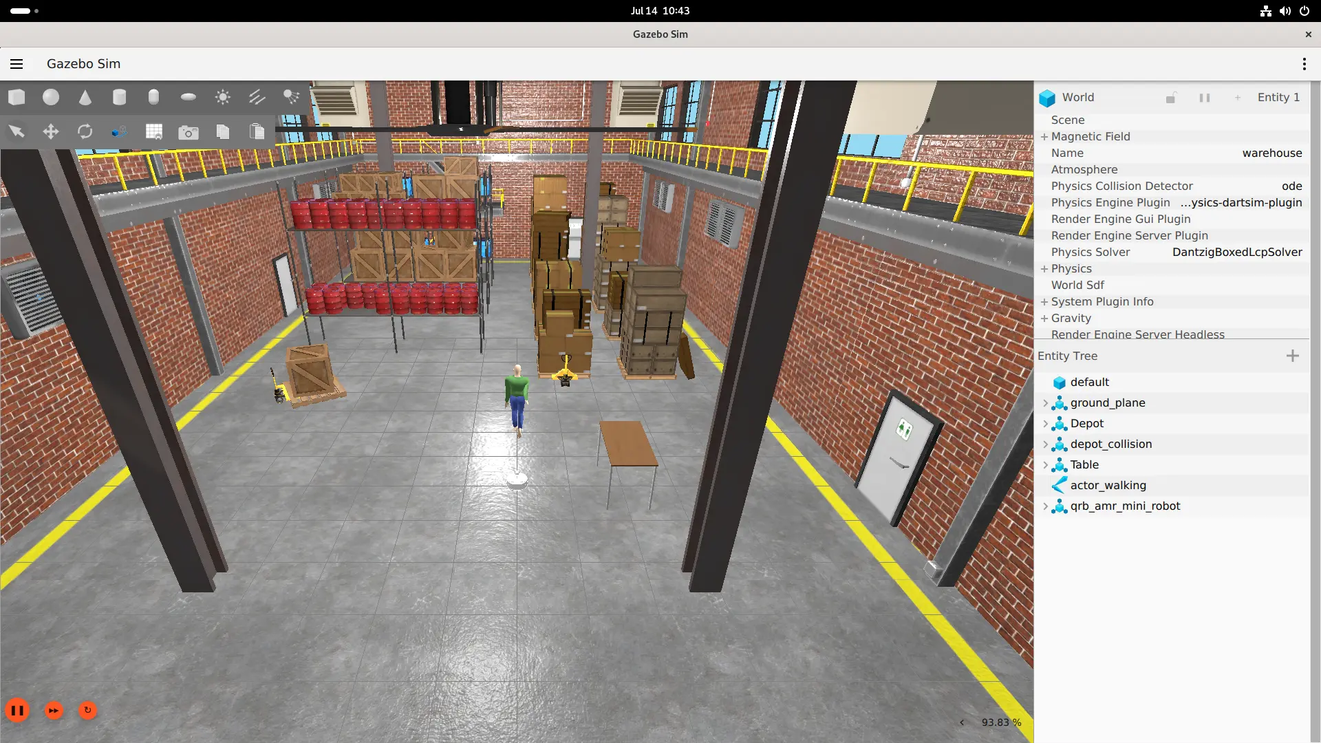

终端 1:启动 Gazebo 仓库跟随场景​
在桌面终端中运行:
radxa@airbox$
ros2 launch qrb_ros_sim_gazebo gazebo_robot_base_mini.launch.py \
world_model:=warehouse_followme_path2 \
rgb_camera_config_file:="$HOME/qrb_ros_samples/robotics/simulation_follow_me/followme_rgb_camera_params.yaml" \
enable_laser:=false enable_imu:=false enable_depth_camera:=true
Gazebo 启动后处于暂停状态。点击左下角播放按钮启动仿真。

预期输出​
持续打印人员检测信息:
Human detected - Depth: 2.00756, Angle X: -0.00312499
Human detected - Depth: 1.80109, Angle X: -0.00937472
Human detected - Depth: 1.49213, Angle X: -0.256708
Human detected - Depth: 1.78986, Angle X: 0.230219
Gazebo 中 AMR 应可见跟随移动演员移动。控制器发布非零 /cmd_vel(最高约 linear.x = 0.396 m/s,angular.z = -0.310 rad/s)。
