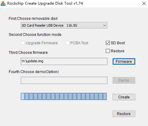

Open the executable file
SD_Firmware_Tool.exeof SDDiskTool and insert the SD card.warningWhen multiple storage devices are connected, please ensure you select the correct SD card to flash, otherwise other storage devices may be overwritten.
Select the SD card to flash from the removable disk devices, choose SD Boot as the function mode, ensure that the firmware upgrade is a complete image in RK format, and finally click Create to flash the image.
Please be patient during the flashing process. The image contains many partitions, and if the image is large, the flashing time will be longer.
If you encounter problems clearing the MBR while burning, you need to change the SD card disk label type from dos to gpt.
