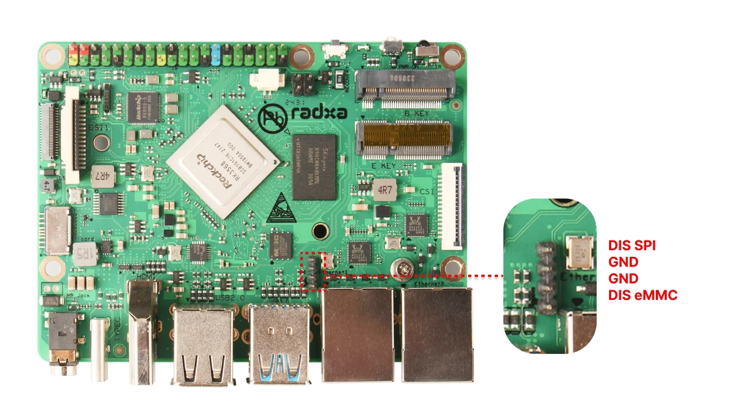

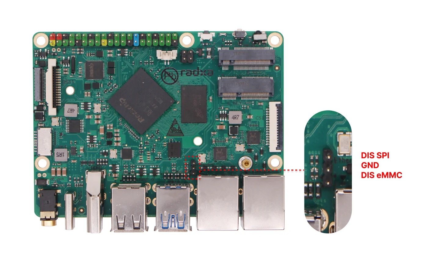

  1. Short the DIS SPI and GND pins, and the DIS eMMC and GND pins.
  2. Toggle the dip switch below the USB 3.0 port to the Device side.
  3. Power the board with the power adapter. A steady green power LED indicates successful entry into Maskrom mode.
  4. Connect the OTG port on the board to the PC using a USB-A to USB-A data cable.
Notes:
  • If no eMMC module is installed, there is no need to short the DIS eMMC and GND pins.
  • To clear SPI Flash, remove the jumper cap or jumper wire shorting the DIS SPI and GND pins after powering on the board.
  • To clear the eMMC module, remove the jumper cap or jumper wire shorting the DIS eMMC and GND pins after powering on the board.
ROCK 3B maskrom pins
