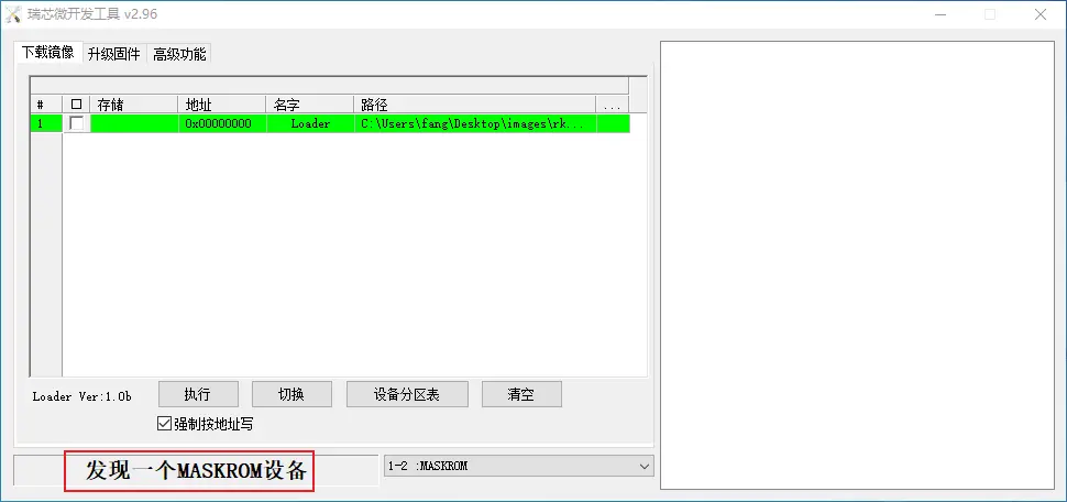

Enter Maskrom mode
If the operation is normal, RKDevTool will prompt A MASKROM device was found.
Flash images into storage media.
eMMC
- Select Loader (see File Download section above, the loader in picture below is just a example).
- Right click, select Add item, select eMMC as the storage media.
- Select the system image (see above section on file download, you need to unzip it into .img format after downloading, the image in the picture below is just a example).
- Click Execute to start burning
If there is a prompt Download complete, it means the burning is complete, the system will be restarted automatically after burning, and you can log in to the system via HDMI or serial port.

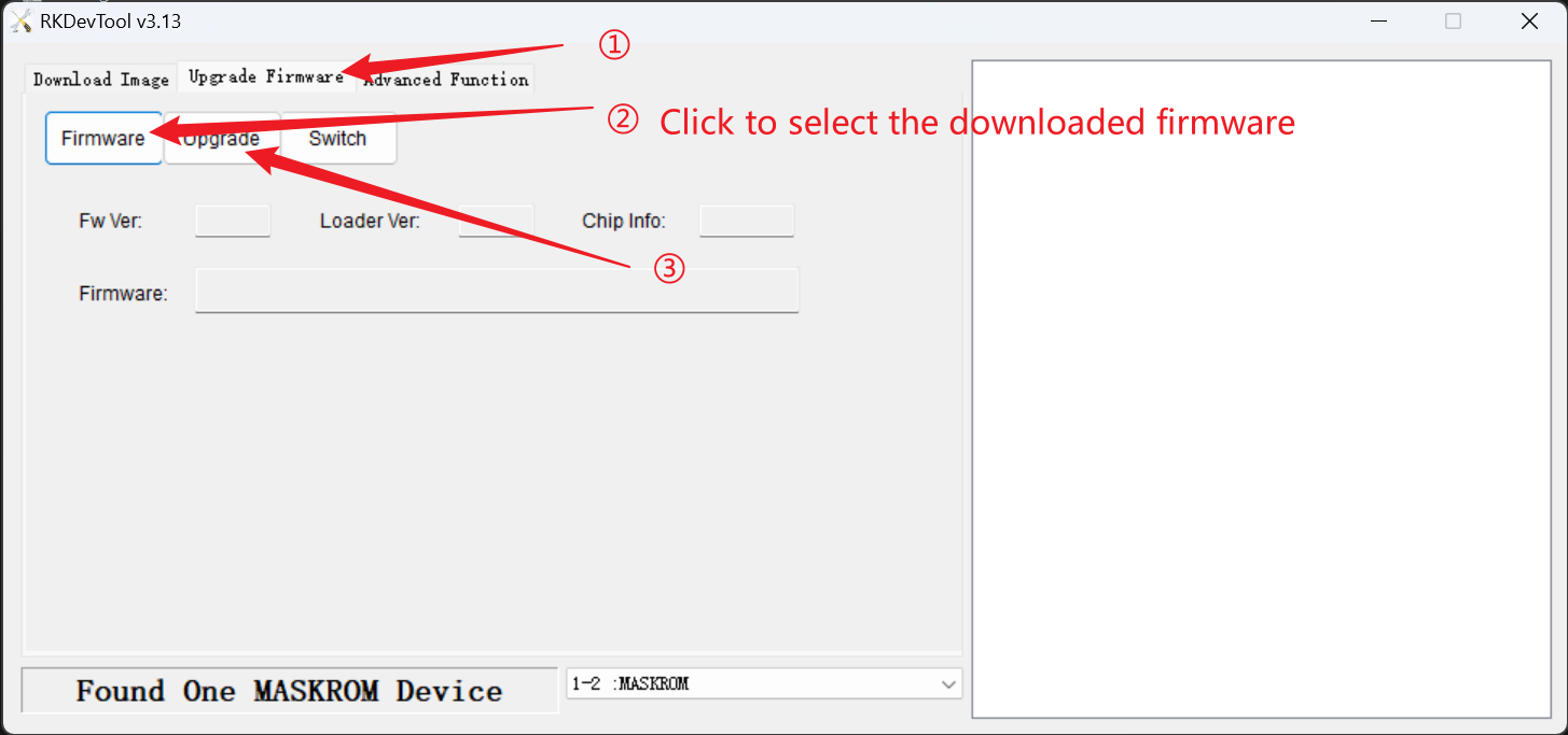

Install RKDevTool
RKDevTool is Rockchip's software for USB burning on Windows platform. If RKDevTool is not installed on your Windows host, please follow the steps below to install it.
Please download and extract the following files to install RKDevTool:
- RKDevTool (Includes Chinese documentation)
- DriverAssitant
Installation of drivers
Download and unzip DriverAssitant, then execute DriverInstall.exe and click the Install Driver button to install the driver.
If you have already installed another version of driver, please click Uninstall Driver to uninstall the driver first, and then reinstall it again.
Install RKDevTool
unzip RKDevTool_Release.zip , click RKDevTool.exe to open.
Enter Maskrom mode
Follow the steps below to flash the operation image
