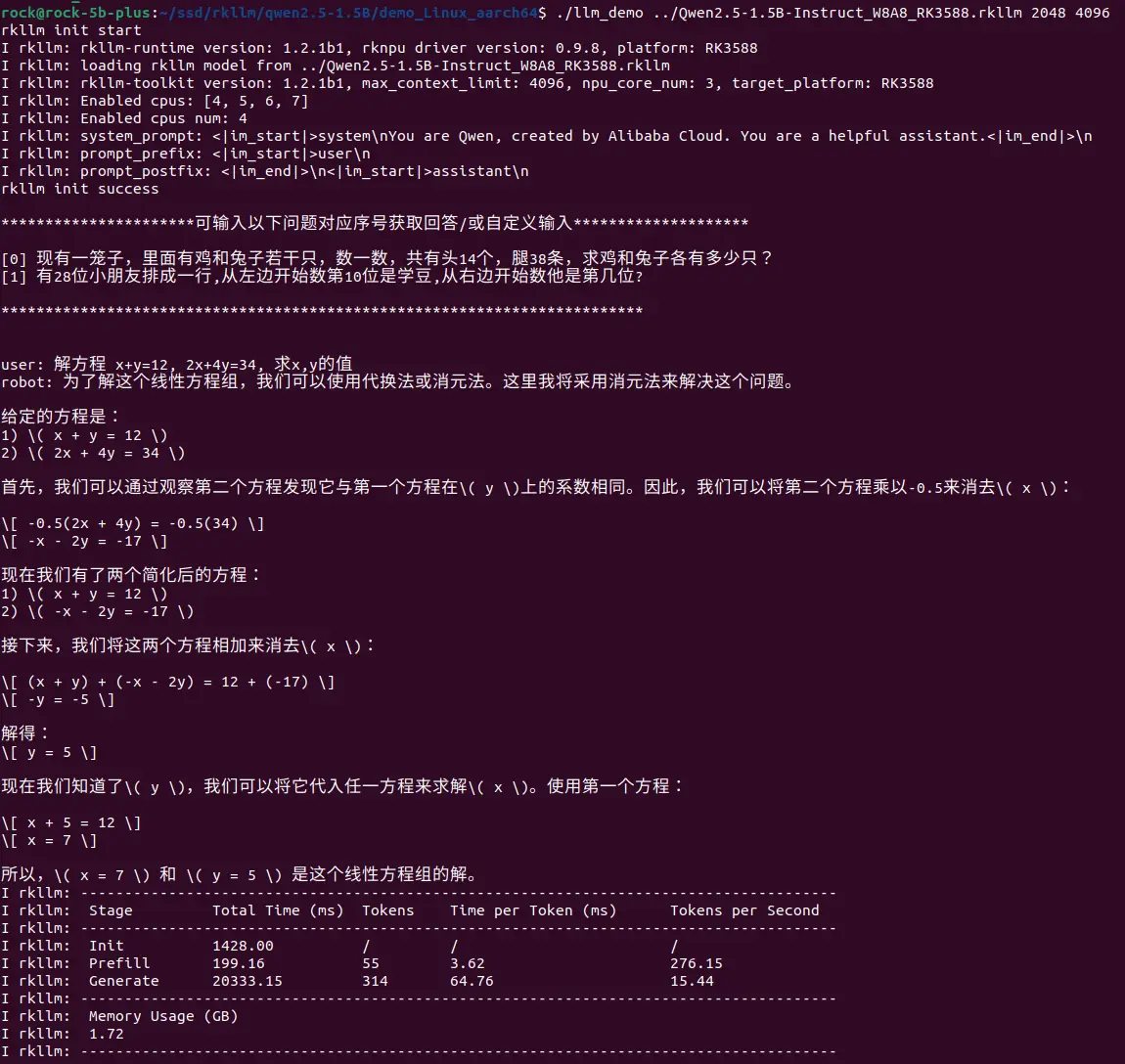

Run
llm_demo
, typeexit
to quitRadxa OSexport RKLLM_LOG_LEVEL=1
## Usage: ./llm_demo model_path max_new_tokens max_context_len
./llm_demo /path/to/Qwen2.5-1.5B-Instruct_W8A8_RK3588.rkllm 2048 4096Parameter Required Description Options path
Required Path to the RKLLM model folder. N max_new_tokens
Required Maximum number of tokens to generate per round. Must be less than or equal to max_context_len
max_context_len
Required Maximum context size for the model. Must be less than or equal to the max_context
used during model conversion
Performance Comparison for Selected Models
Model | Parameter Size | Chip | Chip Count | Inference Speed |
TinyLlama | 1.1B | RK3588 | 1 | 15.03 token/s |
Qwen | 1.8B | RK3588 | 1 | 14.18 token/s |
Phi3 | 3.8B | RK3588 | 1 | 6.46 token/s |
ChatGLM3 | 6B | RK3588 | 1 | 3.67 token/s |
Qwen2.5 | 1.5B | RK3588 | 1 | 15.44 token/s |
